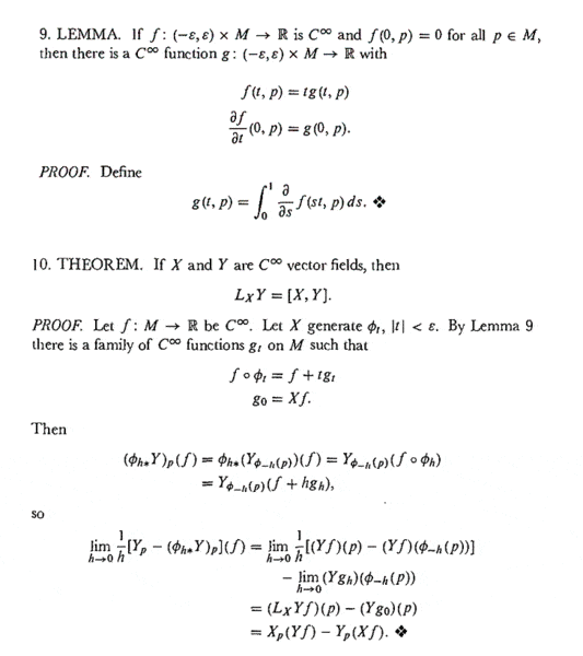

Meanwhile I found the proof in Spivak's book (vol 1., page 155.) The proof is tricky a little bit, but very short.

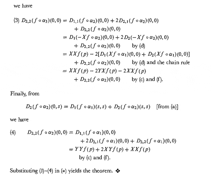

This is his proof.
Thanks! As usual, in my old age, I have to study Spivak's proofs carefully to see what he has done. In the end it becomes obvious (and "why didn't I do that") though.

Sorry, it didn't fit into 3 pieces, here is the end of the proof.
Sigh, this is really bad. I have gone from wondering to having doubts about Spivak's reasoning. Do you want to discuss the doubts? In any case, I will look around on the internet for alternate explanations. I really prefer books(:

Sorry, this post slipped my notice:
rrogers said:
mma:
Spivak question: It seems to me that the notation L_x Y in the second to last line is a typo (or I don't understand); it should probably be the partial derivative. The last line is L_x Y by definition?
Ray
No, I think that everything is OK here. [tex](L_XYf)(p)[/tex] means here [tex](L_X(Yf))(p)[/tex]. Since [tex]Yf[/tex] is a real valued function, [tex]L_X(Yf)[/tex] is simply [tex]X(Yf)[/tex].
The last line is the definition of [tex][X,Y]f[/tex].

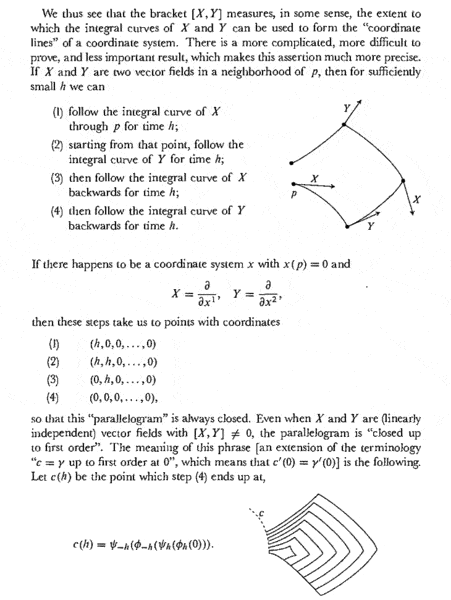

My problems with the second proof:
1) First page
"If there happens to be a coordinate system x"
then
"even if [X,Y][tex]\neq[/tex]0 "
While you can build such a coordinate system at p; the coordinate flows will lift
off of the X,Y flow lines at (h,h, 0,0 ). In other words, in general the required
coordinate system doesn't exist?
2)
At the bottom of first page c() is defined as a point. Whereas at the top of the
second page it is a "constant curve". What is a "constant curve"? Then it's
treated as a function. In any case the definition of c as an entity with
p ->0 ends up defining it as a member of T* ; i.e. a path in the total tangent
space. In that case c'() should have to be defined in a coordinate free manner.
It looks to me as if he needs an entity for the calculations and worked backward to
it; then mislabeled it. Of course I consistently misinterpret things at times;
like the original L_x(Yf) above.

rrogers said:
1) First page
then
Exactly.
rrogers said:
2)
More precisely, c(h) is defined as a point on the curve [tex]c: \mathbb{R} \rightarrow M : h \mapsto c(h)[/tex]
More predisely, c is the constant curve p up to first order.
This expresion is explained on the previous page: [tex]c = \gamma[/tex] up to first order at 0 means that [tex]c'(0) = \gamma'(0)[/tex]
And also explained in the 15. PROPOSITION: c'(0) (= a constant's derivative) = 0
I hope this helps.
